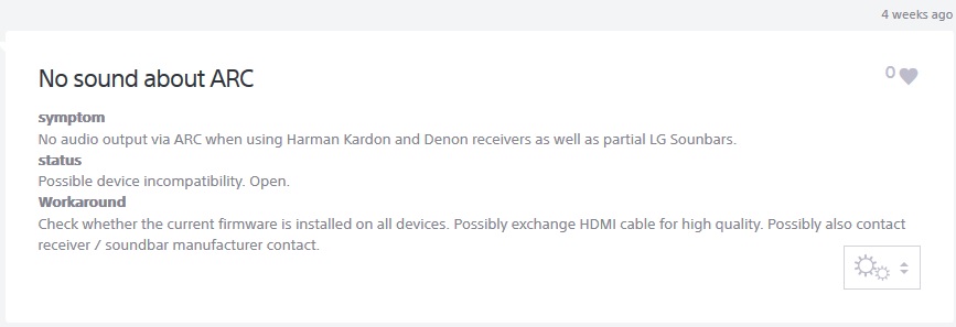

See this link too:
Also, this is posted on the Sony German forums under their bugs and issues thread:
