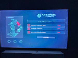

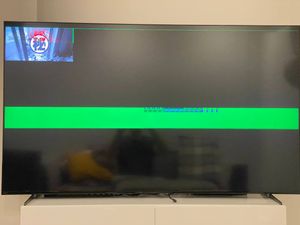

I add photos with issues.
HDMI modes:

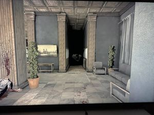

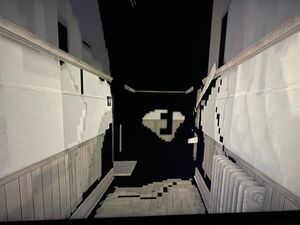

Game Outlast has graphics artifacts:

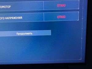

Broken color depth:
