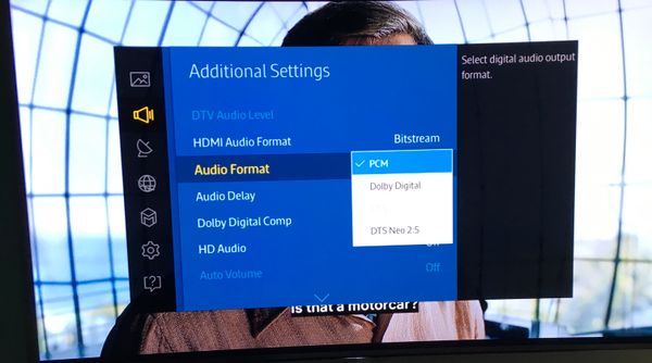

So here’s the Sound menu/Additional Settings display from the Sammy (everything else on the main Sound menu is greyed out, apart from the Speaker List setting, where Receiver(HDMI) was automatically selected when the HDMI cable was plugged into Node, as above:-
It turns out that HDMI Audio Format can be PCM or Bitstream, and on both the audio comes from the Node.
BUT Audio Format can only be PCM; if I choose Dolby Digital or DTS Neo 2.5, everything goes silent**.
Going back to PCM, I can play Netflix just fine, quite as well as the broadcast TV I started testing with.
I can also put the TV into standby, and when I take it out again, the audio goes back to being sent over the ARC to the Node.
I don’t know how the audio settings on your TV map onto mine, but the above Audio Format observations may explain your difficulties here; have a play and see if that is perhaps it.

I just found out from the Help option on the Sammy that Audio Format is a setting for the Optical Out, and so shouldn’t affect the HDMI Out at all.
So I suddenly have no idea why changing that setting should silence the ARC 😢
