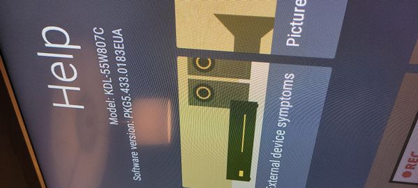

I am.hoping someone cab help me out . My tv keeps powering off  every now and again so I decided to do a factory reset.
I've tried using it settings and resetting I click on yes and nothing happens
Tried using the buttons in the back of tv power and volume down and green light flashes I leave go but its still the same
Tried to remove apps and the apps show uninstalled but when tv restarts all apps are still there. I've added a pic of the model and version.
Version seems to be up to date according to the tv settings.
Thank you.

Click here, https://www.sony.co.uk/electronics/support/televisions-projectors-lcd-tvs-android-/kdl-55w807c/downl...
Update the firmware on your TV to ver 5.547.
Scroll down the page and read the section on resetting your TV.

Thanks I followed the instructions and saying on tv its up to date.
I may have to update it via USB to see if it resolves my issue
Elodin
Moderator
Hey, the software version on your TV is indeed out dated as @daveyh64 said. If you're not able to download it via internet, you'll need to do that via a USB. It is all explained in the link provided. I hope this helps
