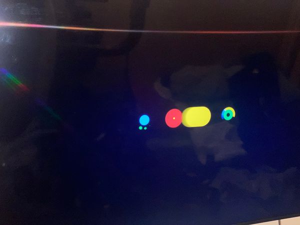

Latest firmware update has bricked my KD49XE9005
Please help!
This morning my Tv automatically began to update...now its stuck in continual restart loop, i have tried everything advised even a forced factory reset.
Even the factory reset keeps restarting while you try to reset, its doing my head in....and completely putting me off buying another Sony TV 😞
