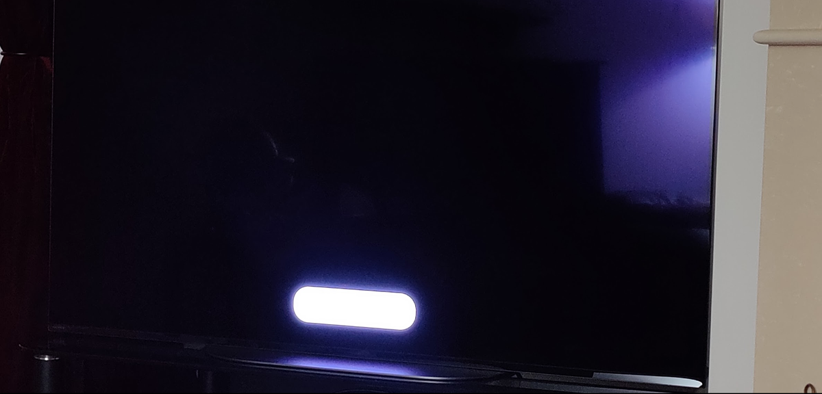

I have just got the Sony A90K 48" TV.  I am very happy with it.  I decided to get the Sony HYT-S40R sound bar to go with it.
I have the sound bar plugged into the HDMI 3 earc port on the TV.  I also have a Sky Q 2tb box plugged into HDMI 1.  If I have the sky box turned on and watching TV, then decide to turn on the  sound bar, it turns on and a toast message appears say it has connected.  The problem is when it connects the screen goes black for a second or 2 with the toast message.
It is a little annoying.  It doesnt happen if I use bluetooth, the toast message appears over top of the screen.  Is there any recommend settings to stop the black screen happening while the soundbar connects.

Hey @srjohnston80, check if your TV is running on the latest software version via this link. I believe this message indicates that the external sound bar is connected is that correct? Providing us here with a picture of the message would make it easier for us to help and assist regarding this.
srjohnston80
Hi @Elodin
Sorry should have mentioned that I am on the latest firmware.  But what happens is when I am watching something from HDMI, for example I have my sky q box connected to HDMI 1 and PS5 connected to HDMI 4. When I turn on the sondbar, the screen goes black.  While it is black a toast message says Audio System Active for a second or 2 then the picutre appears again.  I also go high end 8k hdmi cables with ethernet as well.  Same thing.  I have an official Sony HDMI cable plugged into the sub and into HDMI 3.  I have HDMI 3 configured as standard.
srjohnston80
After that message appears, the screen comes back on again after a second or 2

Thats a little disappointing, but I can live with it.  It doesnt happen if I use bluetooth, just the soundbar.  If I use bluetooth and am watching something on HDMI say the sky box, the same toast message appears on the screen without it going black.
I came from the Samsung qn90a.  Did not like that tv too much and they broke bluetooth on the latest firmware update.  I can easily live with the screen going black for a few seconds, but it would be nice if it did not do it at all
srjohnston80
Here you can see, when I connect my Sony MK5's via bluetooth to the TV, watching Sky on HDMI 1, the toast message just appears on the screen.  The screen does not go black at all.  It would be nice if the same could happen using the soundbar.
As I said very minor issue.  I love the TV, just got the PS5 yesterday and it is amazing with it!
