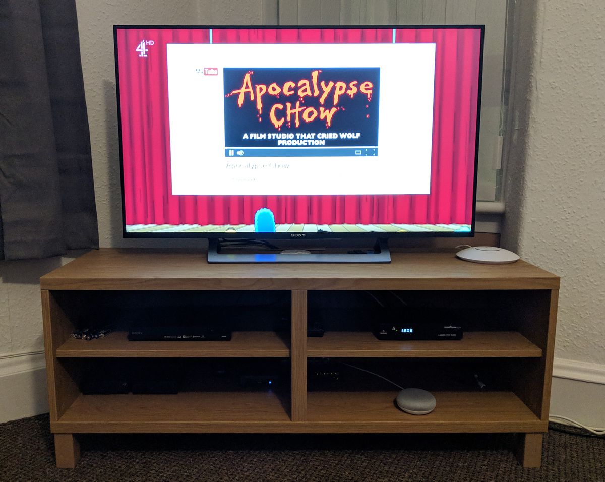

so i've looked further at the ZF9, and it seems good but one possible snag.
the height of it is 6.4cm, but if it sat in front of my TV it would cover the IR port on the front of TV (that sits about 5.5cm from the base of the TV).
my TV sits on top of a TV cabinet, and there would be no other place to sit the soundbar. i'm guessing i would have this proble with most soundbars.

ah so the soundbar itself an act as an IR repeater, so i point to the soundbar and the soundbar then sends that IR on the TV... good to know!

Hi @ch3nks Just to be clear the IR-Repeater is built in on the HT-ZF9. You don't need the one that came with the TV. Quite simply the soundbar picks up the signal from the front and repeats it out of the rear of the unit.
