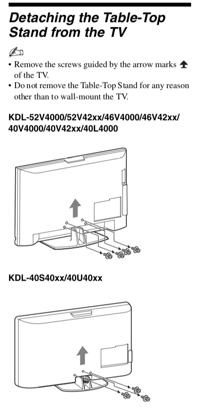

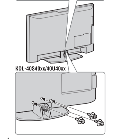

Scroll down to page 4 and there is a graphic showing you where the three screw holes are that attach the table
top stand to the TV. Page 8 is entitled Detaching the table top TV stand from the TV.
See below.

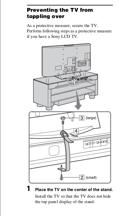

Are you sure the TV stand is attached through the glass top, there does not seem to be anything in the manual discussing this. The only thing I can find is the section where they describe preventing the TV from toppling over
and that is using the strap attached to the Theatre Stand and the base of the TV stand.
See image attached at the bottom of this post.
Are you sure that the TV stand hasn't just become stuck to the glass after all these years.
If the base of the TV stand was rubber and been sitting on glass it may just have formed a pretty strong bond.
