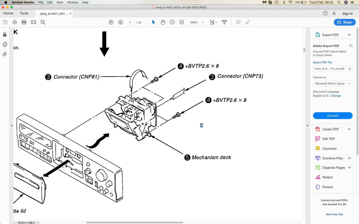

I found the service manual on line and with this ascertained that the electronics were all fine but the tape mechanical unit, called the "Mechanism deck" in the manual, was not working, something was bust and wouldn't do anything. I removed it per the manual and I found that the pinch roller had come off its spindle and the spring had come out of the little groove. Put this back together but stll no joy.

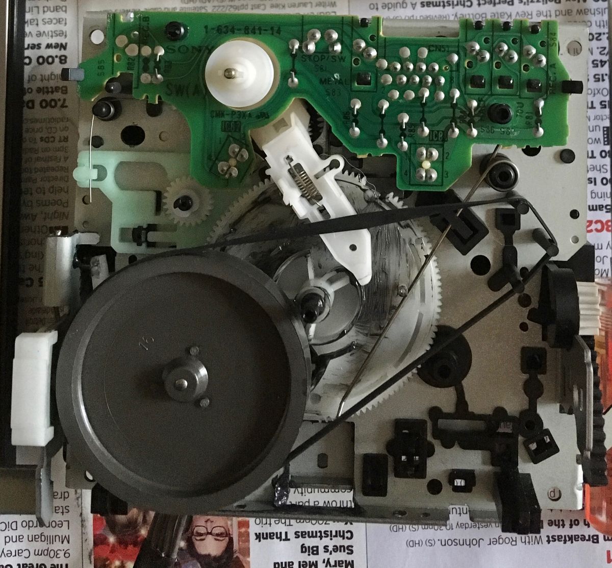

Disassembled the mechanical unit, separated the motors from the main frame, for a closer look. The capstan belt is very slack! Apart from that I can't see anything obvious, can anyone here from the picture please??

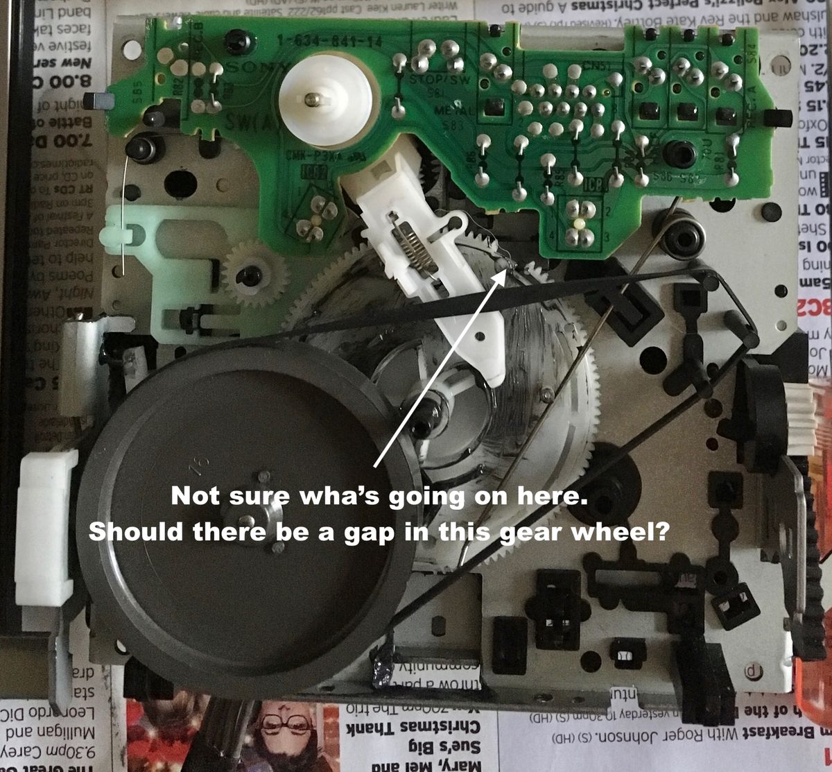

cheddarman
Member
Blencogo - which gear wheel is that please??
Blencogo
That looks like it could be the problem. I don't know if the gap is as designed but I suspect not.

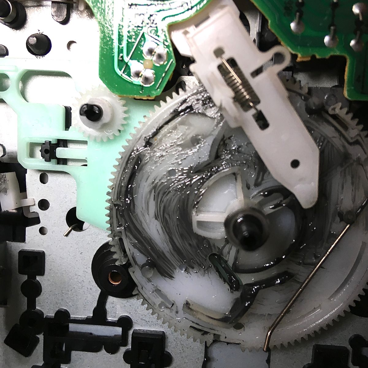

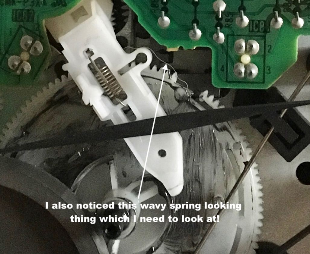

IMG_5439.jpgIMG_5439.jpgI also noticed this wavy thing coming off the bkig geara wheel? Wonder if it's a spring thats stretched or something - needs looking at!!

Opened up again, no sign of a cracked gear on the spindle motor.
Also, the "wavy thing" has gone from the big gear wheel, probably a dog hair!
Looking at the big gear it has several gaps in the teeth and obviously doesnt rotate a full turn?
