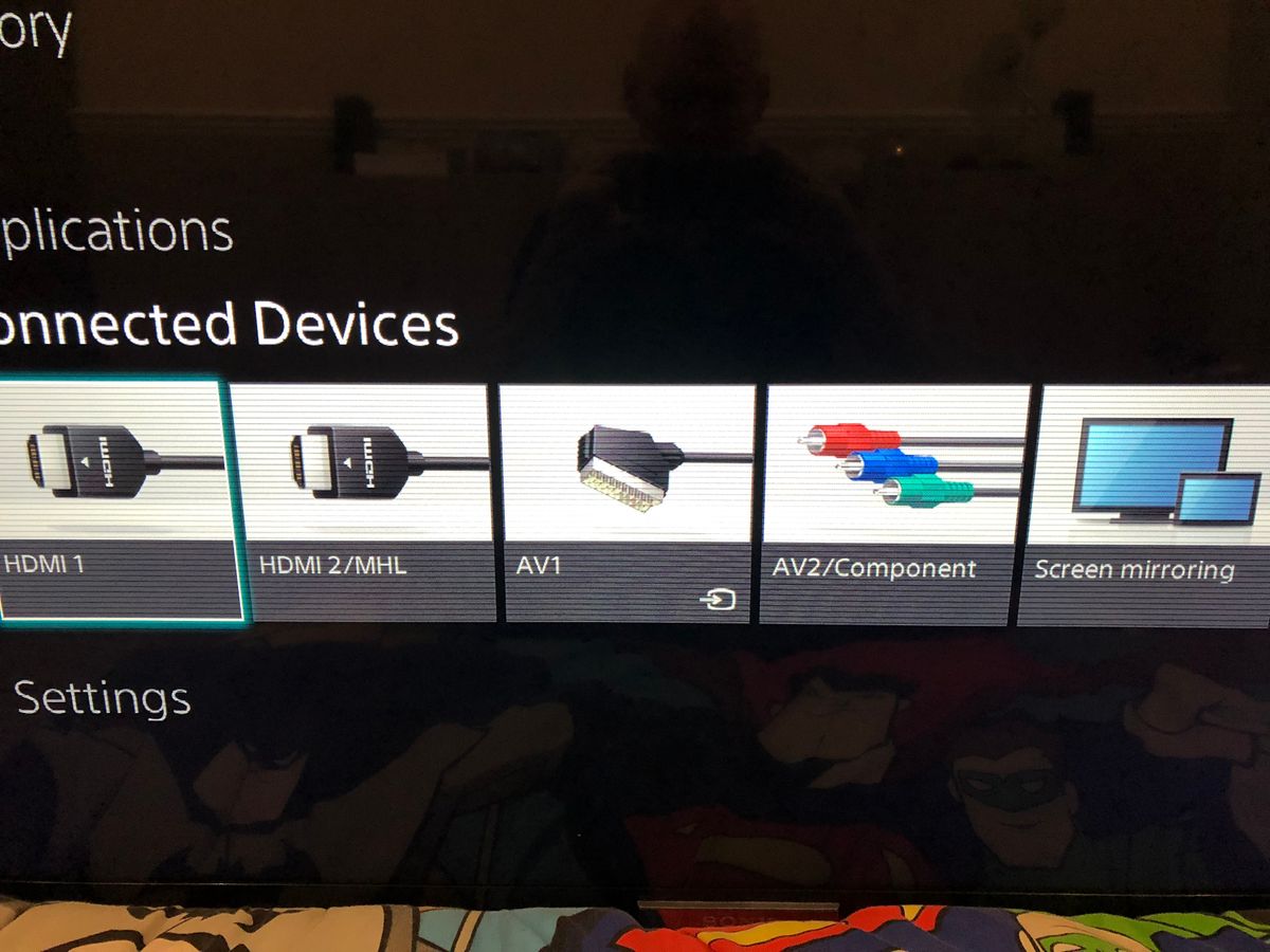

Hoping for some advice / help. My just 5 year old Sony Bravia KDL-50W685A has out of the blue yesterday developed a buzzing / whistling sound and is displaying horizontal black lines across the entire screen.
After spending a few hours on google reading through posts I decided to strip it down, removed all connectors / re-seated them, gave everything a clean up - but no joy.
I originally thought the buzzing / whistling was coming from the main board capacitors, they didn't look blown - I managed by luck to pick up another main board from a chap within a few miles from me from eBay - who will happily give a refund if the part didn’t do the job, but sadly the same end result, so I switched back to my original main board.
Decided to go for broke, so I stripped the TV right down - managed to troubleshoot and this is what I have come to conclude. When not plugging in the connector for the LED driver board I still get the buzzing / whistling sound (But no picture as you would expect) so believe this rules out the LED driver board.
When not plugging in the zif connector ribbon to the T-con board the buzzing isn't there - which points me towards the T-Con board - as its not getting power - hence no buzzing / whistling.
(Not having either of these connected means after several seconds the TV fails and the red light blinks start as you would expect with error codes)
Once I got everything stripped down I could pin down the buzzing / whistling sound was actually coming from around the T-Con board area - perhaps underneath the protective metal shield below the LED driver board, so not the main board after all.

I have added some photos below - showing the horizontal lines then the teardown.

Lines across screen

Lines across screen

Hi, I just had yestarday exactly the same issue mine is a KDL - 42W653A, I worked this morning on the problem and I found the faulty part, the problem is related to the little QFN power ic which drive the LED:
I have bought one on ebay for just £3.69 and replaced on my own.
The following picture will show you where this IC is located:
Hope that will help!
