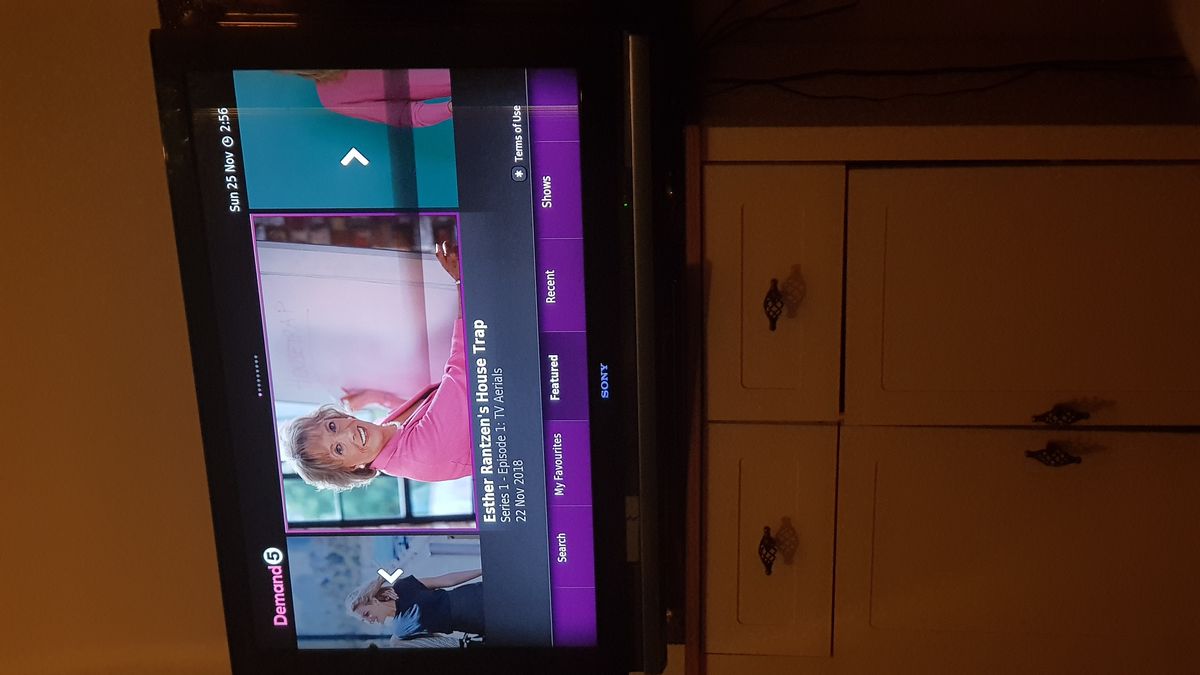

Unfortunately, my newer TV's LED panel has packed in to the point of no return. So, I've resurrected my trusty KDL40W4000. It's been a while since I've used it but it appears that there is a strange flickering and ghosting effect on the tv (see attached images). I suspect it to be a lose connection with one of the led panels ribbon connectors, or out of date software/firmware. There appears to be no updates available. Any help would be mostly appreciated as I can't afford to buy a new TV until after Christmas and I don't want my little ones bored throughout the break. I mean, it is watchable everything works pefect, except that annoying flickering...
Thanks again,
RLV
The warmer the tv gets the less it flickers.

Are the shadows you're getting green and purple?
If so there is a reported fix for gamma correction on another site,
but follow the instructions / download files at your own risk as they
aren't provided by Sony.
If it doesn't help then you're probably going to have to contact Support.

The authorised repair place they sent me to no longer does Sony TV's..😙 He first tried to send me to a repair place that was like an hour's drive from my house...The guy I spoke to at the place that no longer does Sony directed me to Martin Dawes in Warrington. They wanted 70 quid just to look at it, not including any repairs, estimated about 200 quid. So I though F* that. I paid to speak to 2 qualified TV engineers who both said, almost immediately, replace the main board. Main board ordered for 20 quid free postage. Total cost to me 33 pounds. I'll let you know how it is once I have fitted it. İt's such a great TV, connected to Amazon Fire TV, shes a real work horse 📺😎

Changed main board in TV and it worked like a charm. 😁 However, unfortunately, it's downgraded my TV to an older version and I can no longer pick up HD Freeview Channels. No biggie as use Amazon Fire Stick mainly anyway. I wondered, I also purchased a cheap replacement board for a KDL40w4500 which, if I'm correct, will basically *upgrade* the TV to the new HD tuner and also add Ethernet connection and the newer menu system. Do you think it'll work? I could just stick with the board I bought that's downgraded it, but I thought I'd try and upgrade it in the same fashion. Would be an extra bonus to have Ethernet port. Plus, the board that's in and working doesn't even have a USB slot...:/
