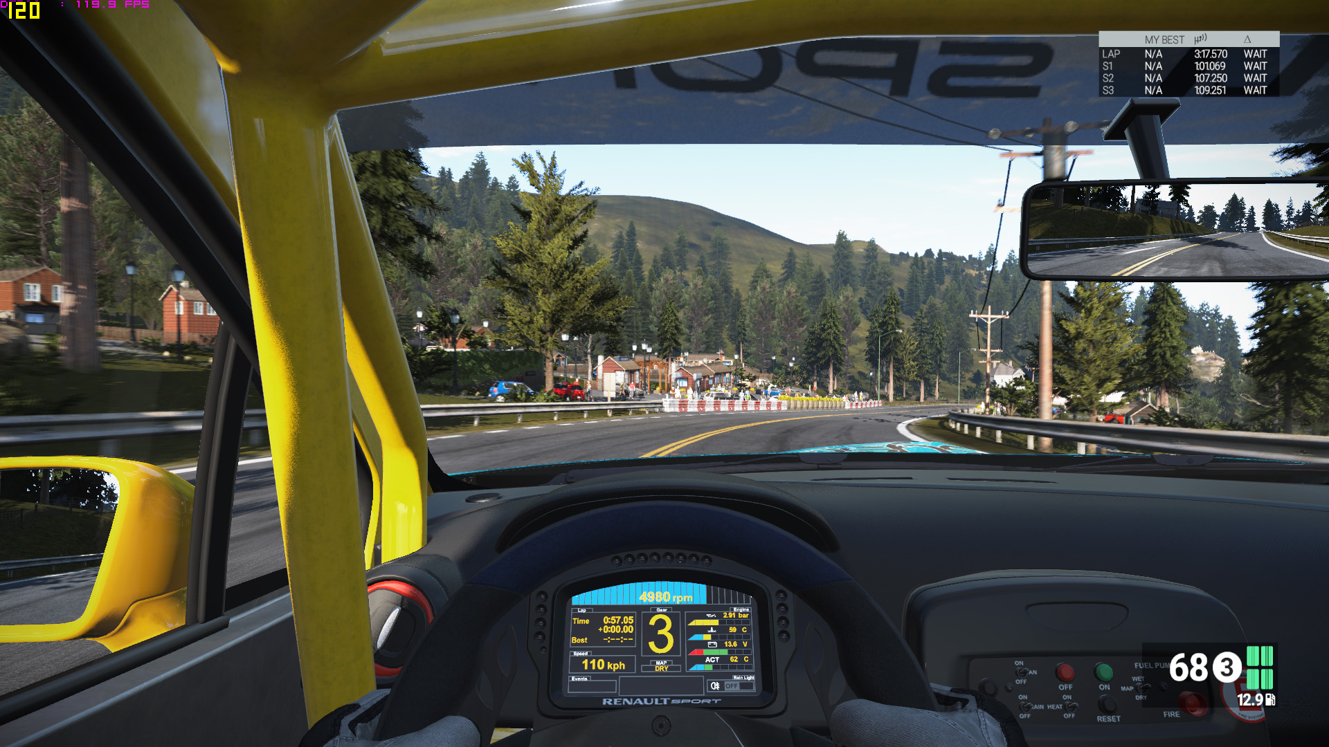

As to the 120hz question, your TV needs to have active 3d,this will mean your panel is 120hz. Mine is, and I just make a custom resolution in nvidia control panel 1080p@120hz and can happily play project cars at 1080p@120fps.

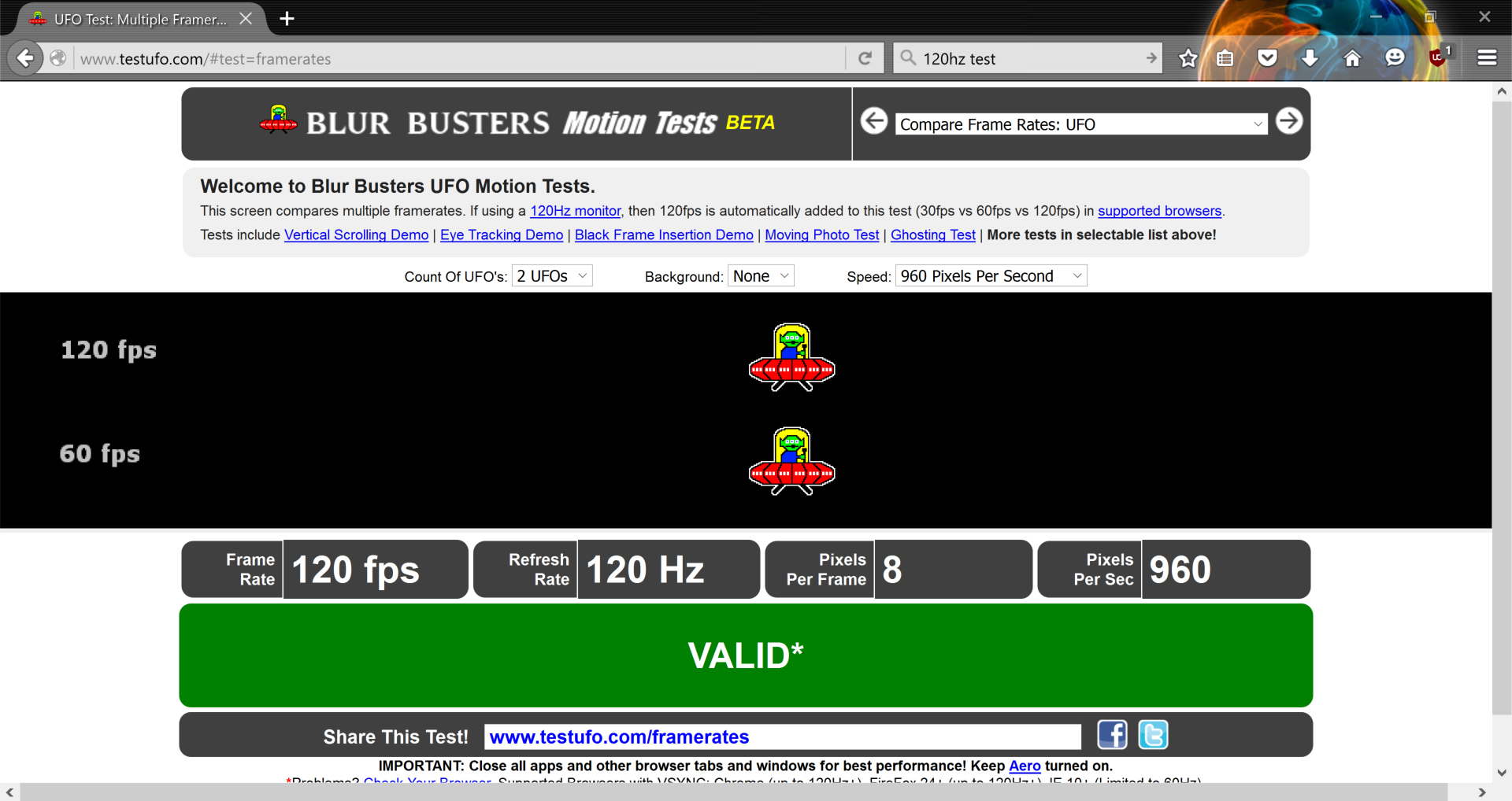

I've got 120hz sorted out but I believe you don't realise it doesn't really work. I've noticed almost no improvement. And to back it up, I used a frame skipping test. And unfortunately it confirmed my fears - this TV skips every second frame so this "120hz" is useless.
You can't have set things up correctly, do you have hardware acceleration enabled or disabled in your browser settings?
Do you have v-sync enabled or disabled in your Nvidia Control Panel settings?
My results :
Refresh Rate Test :
Frame Skip Test :
Project Cars In-Game settings & Fraps and MSI Afterburner OSD Framerate :
Project Cars In Game 1920x1080@120 HZ V-SYNC ON - Fraps & MSI Afterburner OSD :
