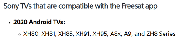

LightFoot
Specialist
Hi @Kreases   What is the model number of your TV? It should be something like KD-65XH8096. Earlier Sony TVs did not come with a proprietary EPG on satellite, so could not use the FreeSat EPG for example.
https://www.sony.co.uk/electronics/support/articles/00183238

LightFoot
Specialist
@royabrown2 wrote:
@Kreases
Glad you fixed it.
I guess we should ask Sony to update their spec for this TV, as it doesn’t mention Freesat:-
https://www.sony.co.uk/electronics/support/televisions-projectors-lcd-tvs-android-/kd-43xh8505/speci...
Hi @royabrown2
Extract from the link I provided:
