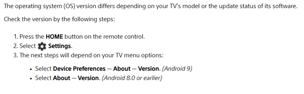

Hi, sorry for the delayed response.
Yes I have got the latest software on the TV. I'm not sure what version I had before. I did restart the TV through the menu. Maybe this picked up the latest version as since this re-start I have not been able to replicate the issue - which is good. So this version may have fixed it.
I'm not sure why the TV didn't pick the update up itself as Auto updates is enabled by default. It is possible that our TV was running with an older OS version as it was one of the 1st to be delivered 4th Septmember. I think that was the launch date in the UK.  Anyhow, thanks for your help. I'll post again if the problem comes back.

Do you have the latest software version installed? When you say reset the cache, is that for individual apps or for the entire TV through the Storage settings menu?

Your describing the same thing I was able to fix with a reset which you have tried and checking I was running with the latest version of the OS also. I've been flicking between BBC iPlayer, YouTube and Netflix on and off now for about a week and fingers crossed have not seen the issue return. We have different models so I'm not sure if the patch that fixes this has been applied to the OS for your TV. It's possible Sony haven't applied it to all models yet. Well it's got to be something like this - or I just havn't been able to break it again as yet. Fortuneltly for me this last point is feeling more and more unlikely now.
Try the OS update again. Force an update too - don't just go with the Auto detect.
