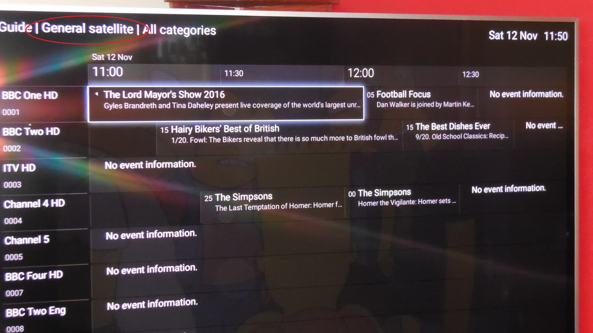

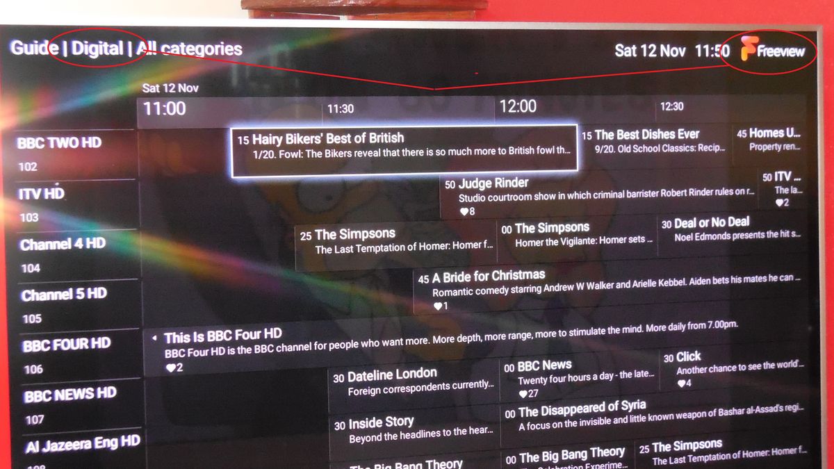

Can you please confirm - Are you trying to use the Digital EPG (which is for Freeview) for the channels on Satellite?   If so, see below.
Please note, Sony TVs are not Freesat compatible - even though there is a satellite tuner in the TVs and you can watch the satellite channels, the term Freesat is the actual company behind the EPG for the satellite channels.  This is why there is only a basic guide (EPG).
I know you can go to the Action Menu and change the 'broadcast' whilst in the EPG - However all you are doing is changing the TV from Satellite to Digital (Freeview) and doing it this way is simply a different/shorter way to 'hop between' satellite and digital EPG guides See pictures below:

In answer to your first question, yes, but only to see what's on, not to navigate channels  - it only switches from satellite to digital if you actually select a programme from the guide, otherwise the tv contInues to show the current satellite channel.
I think I confused things by referring to Satellite channels as 'Freesat'
Anyway, I think In answer to my own question - It's not possible to change the default guide for satellite. The guide for satellite is quite frankly garbage.
