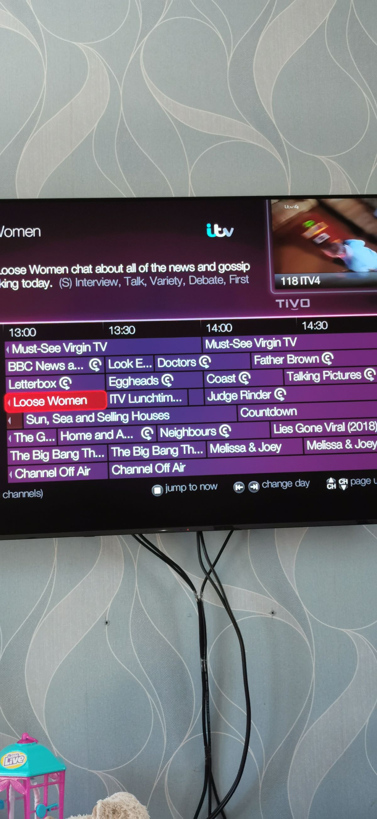

Hi. It's the KD-55AF9 series. Bought from Curry's.
I'm sorry, but since I don't now how should appear it is not easy to understand: may be is better if you use reference one color background images (you can find them easily on youtube)...
Hi thanks for the response. If you look at the centre of the image, especially on the TV guide you can see the pink turns more purple. I also get it with yellows turning green.
Thanks
I also forgot to mention the centre of the screen is Very hot compared to the outer section of the screen.
