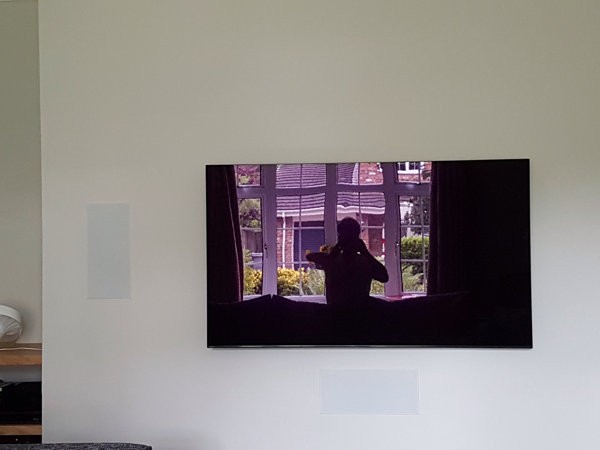

YorkieCampo
Member
Its quite difficult to capture on photo but here is one that I sent to Sony...
It's just above my head and the second one is to the right of it.
Anonymous
Not applicable
Hi there
Its interesting that you say that there is no distortion in the picture.  I can see where you are referring to.  I would have though there would be a little 'warping'.
Its the first ive seen (or heard) of this problem anyhow

YorkieCampo
Member
Cheers for the reply.
I find it odd that there is no distortion or warping to the picture.  Plus when you look at the panel side on it appears to be perfect so not really sure which layer of the panel the dimple resides on.
I have logged it with Sony now anyway and subitted the above picture along with a short video capturing the distortion.
I should hear back from them tomorrow morning so let's see what they say.

Risc0n
Contributor
Wow, that looks horrid. I would be sending it back straight away, not acceptable for a £3500 TV imo.
