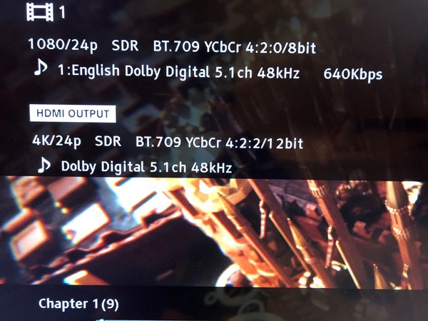

IMG_0213.jpgHi, don't know if any body can help here? It's a X800M2 Blu-ray Player.
As in the photo the 'HDMI OUTPUT' says DD 2.0.ch. I have a 5.1ch sound system. Should I be looking at the top info or the lower info, what's is actually being output?
Am I actually getting 5.1ch or 2.0ch?
Cheers!

Hi Kai,
The source is 5.1 (disc) but the player outputs 2.0 channel only.
Please check the audio settings of the player in the menu - maybe it's set to PCM (2ch Stereo).
Else your sound system might not accept the surround format so the player only outputs 2ch audio.
Cheers
Peter

Maybe I will need a HDMI switch as my Samsung TV might not have 5.1ch passthrough?
If your receiver can pass trough image signals you should connect the player to the receiver.
Kai_jim7
Poszukiwacz
Don't have have the right ports on my Soundbar (receiver) only HDMI out and Optical. In the end used HDMI Audio Extractor to pass through 5.1 audio, and used original blu-ray ports to pass through the video signal.
Thanks for the help!
