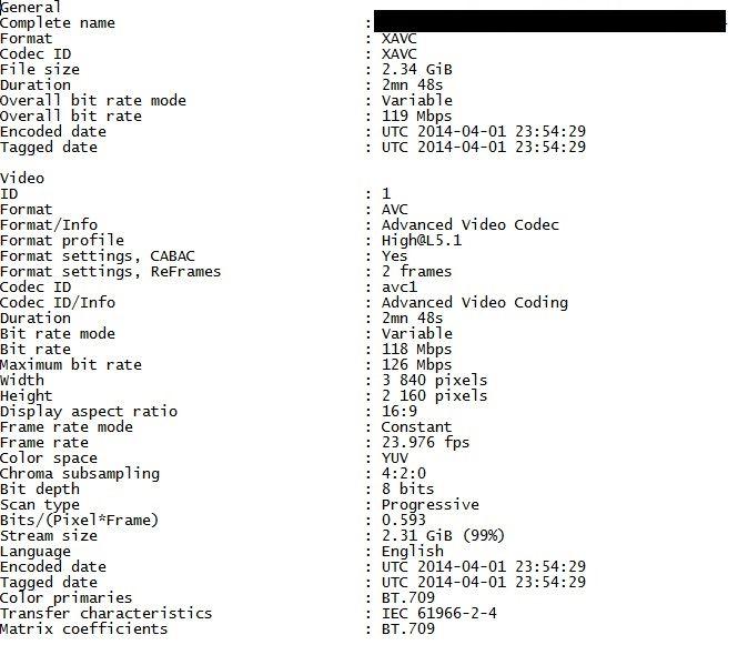

Unfortunately I am unable to test a 4K H.265 file – as I do not have access to one. So I cannot give a direct comparison between 4K H.265 and a 1080p H.265 or even 4K H.265 to 1080p H.264. However I have tested 3 types of files (4K H.264, 1080p H.265 and a 1080p H.264)
When decoding a XAVC (H.264) 4K file, there is a massive difference in CPU load between having Hardware Accelerated Decoding enabled, compared to when its disabled. The CPU cannot cope unless decoding is done via hardware. As the hardware is designed to decode the H.264 codec, there is also a difference between the GPU loads, which amazingly they are decreased as well.
There is a massive 60% to 166% difference between decoding a H.264 1080p file and a H.265 1080p file depending on whether the H.264 decoding is done via hardware or not.
Adding this difference onto a 4K file would certainly prove that a 4K H.265 file would NOT play WITHOUT hardware decoding – of which it has not been done.
I also must conclude that a TV (of any brand) certainly would not be able to decode a 4K H.265 in software alone. A 4K H.265 @ 15Mbps stream via Netflix is one thing, but higher bitrate video files are another.

Please, please, please just stop. All your tests actually prove the opposite point, as your PC is bandwidth limited by the virtual memory resident on a HDD that is many magnitudes slower than the memory buffer a 4K TV will use for DSP. Even then, the bandwidth of you laptop's RAM will be magnitudes slower than the small but very fast memory used on DSP boards.
The h.264 data you are processing is an offline file, not a 15Mbit/sec datastream, and even then the data you are reading in, is roughly 4times the datasize(and IO bandwidth) needed to read the data into the a h.265 decoder. The Pc is also far away from being used as dedicated hardware, in which it would gain massive advantages
