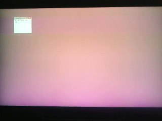

A magenta checkerboard (that the TV turned brownish) changes color depending on what's else horizontally:
Background color is supposed to be a uniform magenta.

Vertical color gradient on a magenta checkerboard. It's not due to the viewing angle. It looks mostly brown/grey both because the TV processing turns it brownish, and some because of the camera. I'm not sure the gradient is related to the same processing problem as above.
Gradually more magenta at the bottom.
