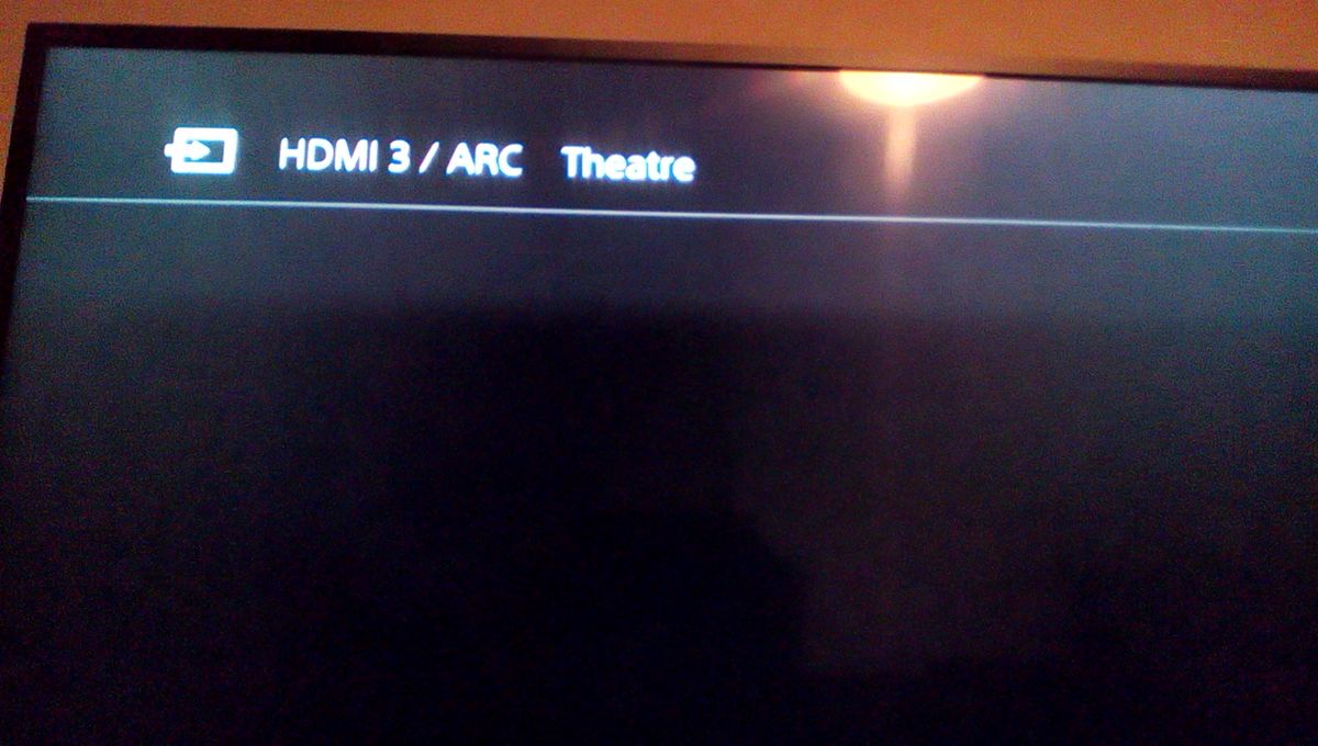

Last week I bought a Sony Bravia 55xd8005 hdr und tv,last night I noticed on the input screen a grey band about six inches deep going along the top of the screen,thing is its only on two of the inputs -ps4 and blue Ray and not on any other,they also go when device activated.Is this normal?Thanks

Not quite,my issue is a grey bar on the input menu that goes when device is activated,can't be the ps4 as in the other input its fine.
Mike-J-N
Explorateur
After being advised by Sony to do a master reset I have indeed singled it out to the ps4 connection,it only happens when HDR10 is activated on the tv,now I'm confused as to why it's doing this

Ok,I have set the enhanced option and was hoping this would fix it but alas it's still there,apologies for the poor pic,I have tried several cables,the current one is a high speed 4k cable.Hopefully you can just see the grey banner on the topIMG_20170719_2321143_rewind.jpg mm

strangely it has now 're occurred on the hdmi3 input,been fine all night,now it's back,again apologies for substandard pic,blame my Kindle FireIMG_20170719_2340447_rewind.jpg

This to me seems like a HDMI cabling issue - I know you have stated you have swapped the cable.  Can you try separating the HDMI cables as far away from the power cables as you can (i.e. dont bundle them up).  Im more thinking of EM interference.

Tried that to,all my cables are loose,and for some reason when I switch settings on the info banner (left on right off) the display on the banner doesn't alter.Should have stayed with my plasma tv.However I do appreciate your help.

Exactly the same banner displayed off and on.Time for a refund?IMG_20170720_0025339_rewind.jpg
